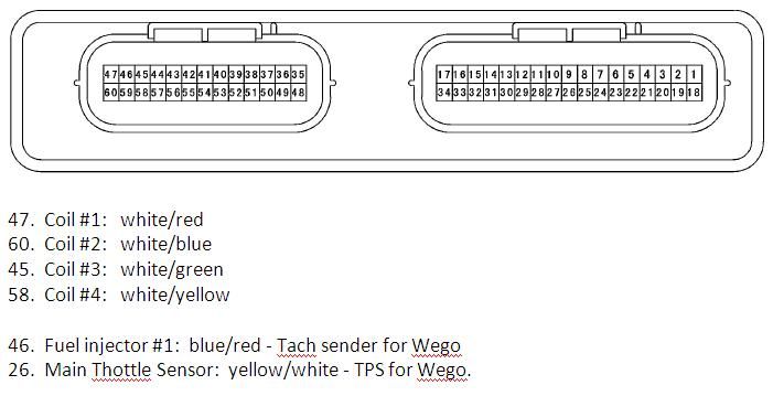

06 -11 ZX-14
The rest of the install is a matter of wiring and plumbing, depending on your choice of “air” and electronics. The Carolina Cycle regulator (part # 12050) will serve well to step down Nitrous or CO2 to 125 or so psi.
If you go with the MPS Autoshift box (1-0299) the following wires on the 2006 – 2011 models will be tapped in at the ECU as shown. Please do a reality check and confirm that these colors correspond to the numbered wires at the ECU, since I do not have access to an older model to look at.
#1 white/red
#2 white/blue
#3 white/green
#4 white/yellow
To make those wires easy to find, it will look like this:

Anyone have a diagram or info on how to hook up the PCV as a Kill box? Ive seen one for a PC3 with 2 relays, but not for PCV. Using the MPS kit here minus kill box. Thanks.
http://www.mpsracing.com/products/MPS/autoshift.asp
Wed Oct 08, 2014 8:25 pm
Joined: Tue Mar 18, 2014 11:53 pm
Posts: 131
Also does anyone have the software for the quick shifter. I can't find it anywhere. Thanks.
Thu Oct 09, 2014 5:37 pm
Joined: Thu Oct 17, 2013 10:47 am
Posts: 155
Is this what you are looking for? This is not my area of expertise so cannot answer questions about this diagram. Its not my work. I copied it off this wonder full site.
Thu Oct 09, 2014 6:02 pm
Posts: 131
I got it figured out. It was for a friend of mine. That diagram will make it much easier in the future though, thanks so much.
Air shifter sure makes a nice difference, I rode his 14 afterward and can't believe the difference. Even though I shift clutchless it is nowhere near as quick or smooth. Gotta be worth at least 2-3 tenths. I've been sticking with the foot shifting and made it to 9.2x, but now I'm sold!
