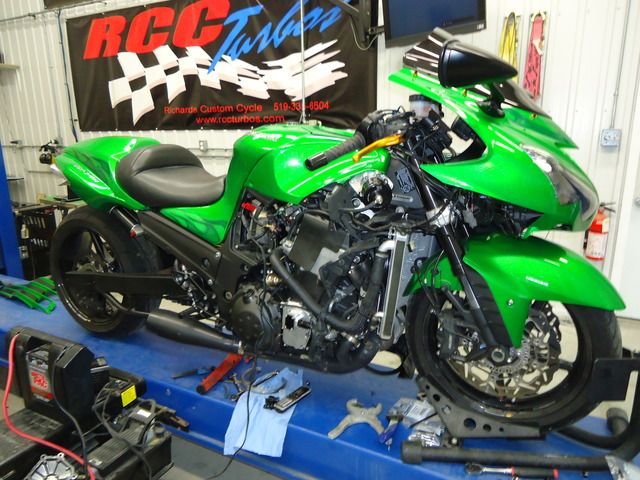

Managed to spend some time at RCC over the weekend. And For All You Boost Lovers out there I'm Happy to report the RCC Mechanical Oil scavenge will soon be available for us Kawi Guys. Very Soon.
No longer will a electrical pump be required. Welding in a return fitting into our oil pans just became obsolete. One less thing to worry about. If any of you ever had a blown a fuse or suffered premature pump failure you clearly understand what a blessing this is. Very Nice Design. Very Very simple to install. Light Weight, Clean. Luv it.
Sneek Peek. Pic Shows My bike being fit tested with the prototype. The finished unit will be black anodized I'm told. Soooon, can't wait.

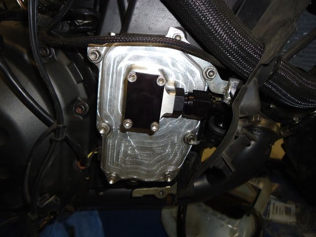

Arrived today and install finished. Really clean and simple product and nice install.
I must add that Richards honesty is beyond reproach. I had an issue with my PayPal and it seemed the payment did not go through which I got confirmation from PayPal a few days latter. So I did another payment and apologized to Richard. Turns out the first payment did go through advised Richard and he immediately refunded me the second payment. Top bloke right there.

Well I have done probably 50 pulls on the dyno in the last week and this pump has worked perfectly, don't matter if it's a full power run, part throttle cruise, idling, roll down from full revs or start up, simple answer is it works the way it should.

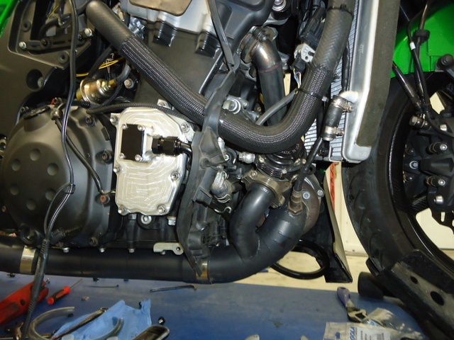

I bought the cover from Richard too. For a new project.
The quality is excellent!
