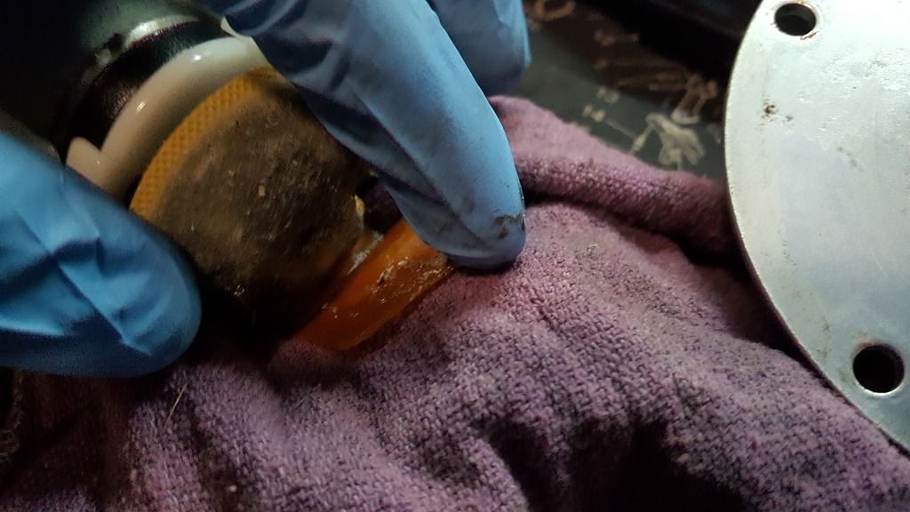

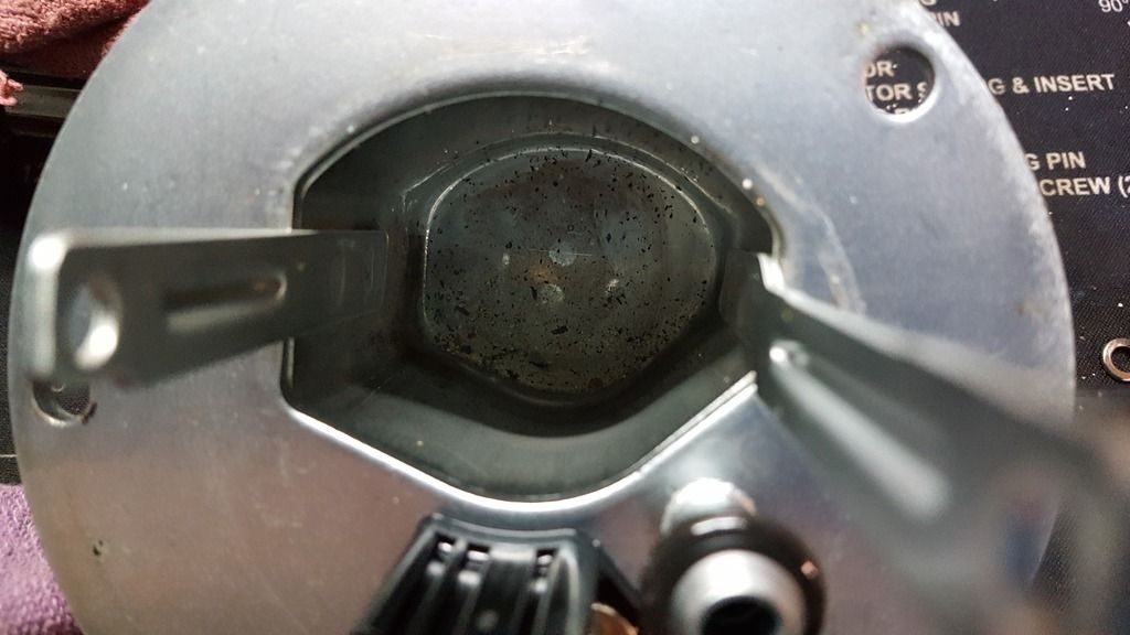

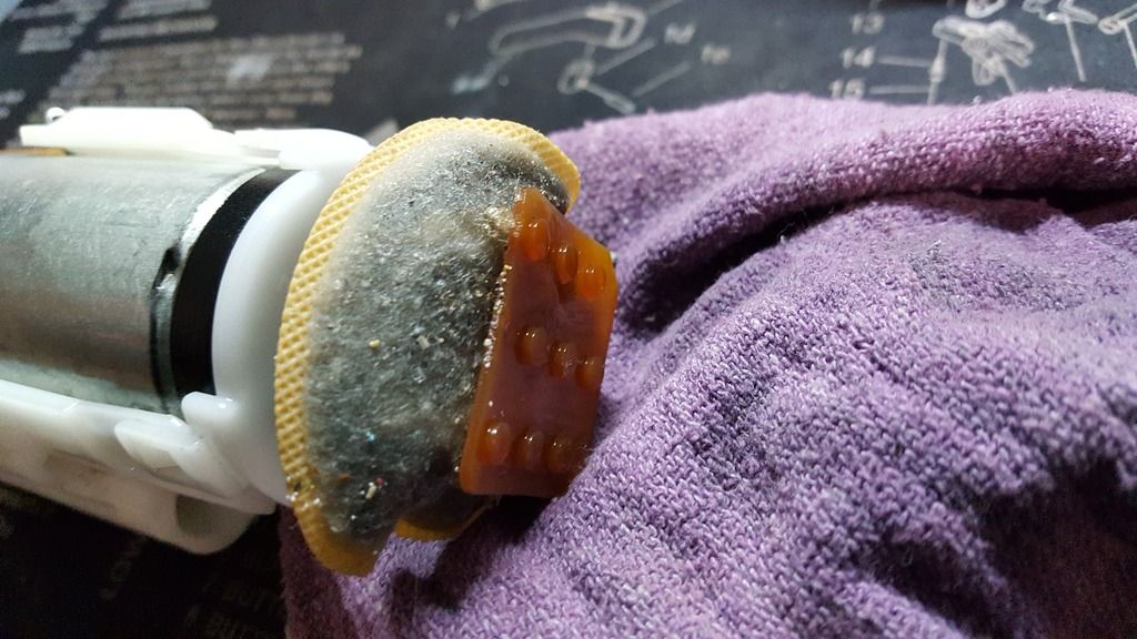

After last TNT, I was really thinking about what KJ mentioned regarding the fuel pump. I have a 2006, the 06/07 fuel pumps are a different design that protrude from the bottom of the tank about 2" with a "canister" design. I am pretty sure that the fuel pump bottomed out on a few launches last time out as well. One time, I felt it hit and it bent my tiger tail a little where it squished between my nitrous bottle and that "canister."
Also, from the Service Manual, the 06-07 fuel filter is not serviceable and it directs you to replace the fuel pump if its clogged.
After some research, I found that the 08-11 Fuel Pump is a direct replacement for the 06-07. In thinking about this, I figured that its totally worth it to swap out to the 08-11 fuel pump to gain the clearance, even if my fuel pump is not an issue.
A brand new fuel pump is $380. Ouch. But, the fuel filter is replaceable in the 08-11 pumps. (Kawasaki doesn''t tell you this, but there have been some smart dudes that figured it out.) BTW, the Kawasaki part # for the replaceable fuel filter is 49019-0013. The replacement o-ring that mates the pump to the tank is part # 670E5075.
I was able to find a very good used pump on ebay for $80. I bought a new fuel filter and o-ring. There are a plethora of 08-11 fuel pumps on ebay, if anyone is interested...
So, I swapped out the fuel filter on the "new" pump. The old filter was in really good shape, which I was happy to see considering its a used fuel pump.
I drained the tank and swapped them out. I wanted to see what was going on inside my old fuel pump and it was pretty concerning. It was full of sand, grit and flakes. In was in terrible condition compared to the 08-11 fuel pump, which the fuel filter looked great, but I went ahead replaced it anyway.
Needless to say, but I must have been having problems with fuel delivery. I took the bike for a ride after the swap. I feel like its idling better. But, I can't really tell if there is any difference otherwise. Nearly impossible to get it above 8k rpms unless I get on the highway. I was hoping to get to the track tonight, but the rain has thrown a wrench in those plans. Will let you know...
