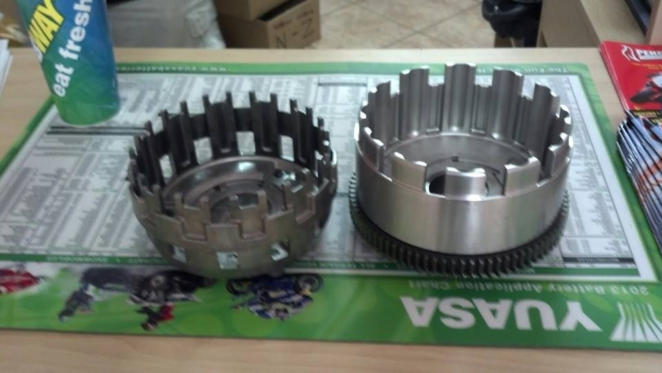

Lee Pritchard and I are rebuilding my clutch on my 2000 A1ZX12R. It already has the muzzy muzzy clutch kit w/ hub, 3 stiffer springs, muzzy steels and fiber. I also have the falicon billet basket.
I went to the track and spent my clutch. Not horrible, but if you spin it over 9000 rpms it will slip. I heard Rick has a good set up for the track. Does anybody have any suggestions. Lee knows his way around bikes like a doctor, he's just never worked on the ZX12's.

Just run good OEM steels and fibers. Triple check stack height. 13 years old may as well get a new clutch cable. I imagine you are stretched so I can't help you there on setup. Stock motor/wb 3 springs stock 3 stiff is perfect.
DO NOT SKIMP ON THE BILLET CLUTCH BASKET. GET IT CUZ ONCE YOU RUN 1.6 60 FTS I CAN TELL YOU WHAT HAPPENS :fishslap:

I already had one made from Falicon. Dam it is pretty.

i havent bought fibers in a few yrs, but i go through some steels. been having better luck with cycle concepts steels. next time i do buy fibers i will try their drag pack
